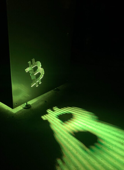

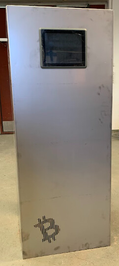

Wanted to share my company’s second heating system project the Bitcoin Boiler.
We have been building and installing immersion and hydro heating systems in Finland for 2 years now.
Our current heating system is designed to both home heating and small scale industrial use cases.
Boiler holds 1-2 Hydro antminers and produces 5,3 - 11 kW of heat.
System has realy which is controlled by spot electricity price.

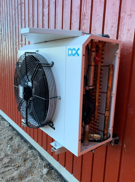

System pushes 60C degrees into a puffer tank, 3way valve controlled with thermostat so that during summer extra heat is pumped to a drycooler outside.
What do you think?
I would like to have some feedback and ideas. We have sold our systems so far just locally but this year we are aiming to build our online shop and start to sell it worldwide.
Here are couple pictures and our website etc:

  • Is the dry cooler necessary? What if you only want to mine when you want heat?

-Yes and no. If we install the software to ramp up/down then its not necessary. Often electricity price is near 0-5cents per kWh during summer time so its extra income for the household.
