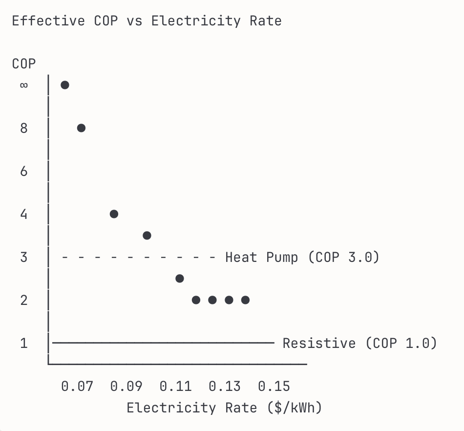

Here’s how COP_eff breaks down for a Whatsminer M64 (228 TH/s, 22 J/TH, 5000 W) at various electric utility rates, with 0.037 $/TH/s/day hashprice (all-time low…)
The kicker: at 0.07 $/kWh electric rate, the device COP approaches infinity, because the heat is free. (Again, at all-time low hashprice, mind you).

Take a look at how COP_eff changes with various electric rates. Where do you fall on the chart?
| Electricity Rate | Daily Elec Cost | Daily BTC Revenue | Net Heat Cost | Revenue Ratio (R) | Effective COP |
| $0.07/kWh | $8.40 | $8.41 | -$0.01 | 100.1% | ∞ (profitable!) |
| $0.08/kWh | $9.60 | $8.41 | $1.19 | 87.6% | 8.1 |
| $0.09/kWh | $10.80 | $8.41 | $2.39 | 77.9% | 4.5 |
| $0.10/kWh | $12.00 | $8.41 | $3.59 | 70.1% | 3.3 |
| $0.11/kWh | $13.20 | $8.41 | $4.79 | 63.7% | 2.8 |
| $0.12/kWh | $14.40 | $8.41 | $5.99 | 58.4% | 2.4 |
| $0.13/kWh | $15.60 | $8.41 | $7.19 | 53.9% | 2.2 |
| $0.14/kWh | $16.80 | $8.41 | $8.39 | 50.1% | 2.0 |
| $0.15/kWh | $18.00 | $8.41 | $9.59 | 46.7% | 1.9 |
