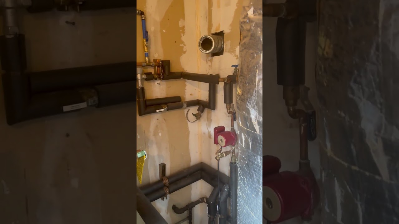

Existing Hydronic system
Provides domestic hot water as well as heating to the house. Main components:
  • 75 Gallon oil-fired water tank
    • Four ports: cold in, hot out, hydronic supply, hydronic return
    • Always-on circulation pump between hydronic supply and cold in ports
  • Three air handlers, each with their own thermostat and hot water coil/pump

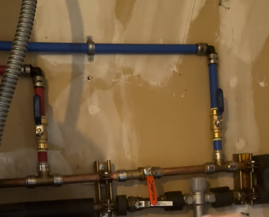

Modifications to hydronic system
Bypass loop
To connect the existing hydronic to the Hashrate House heat exchanger it was just a matter of adding a bypass loop before the cold input port on the tank and hooking up to the heat exchanger ports. That way new water coming into the tank as well as the water already in the tank will be passed through the exchanger.

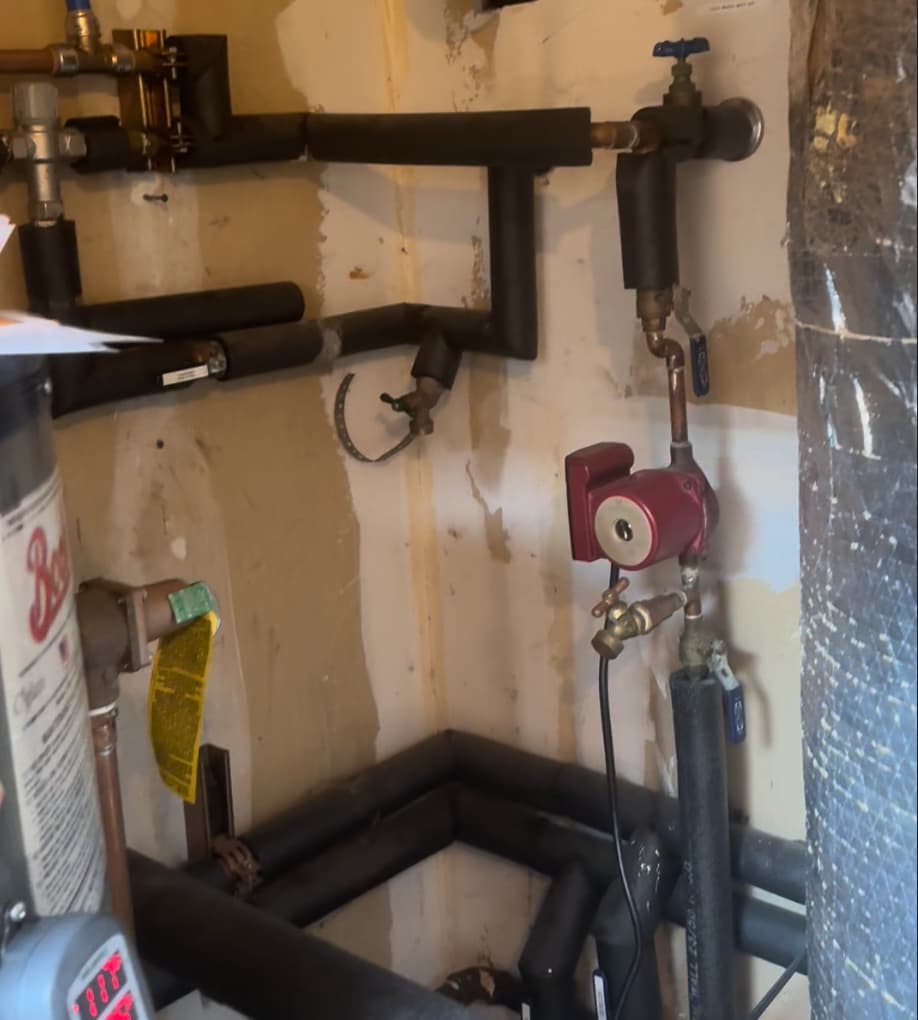

Circulation pump logic
Since I wanted a way to set the temp for the hydronic tank (other than the built in aquastat for the oil burner), I added a thermostat controlled plug. I plugged the pump into this and attached the probe to the tank under the insulation and set the desired temp (140f). That way the pump will run when below the setpoint and stop once its up to temp. You could probably do something more advanced with home assistant but trying to keep it simple.

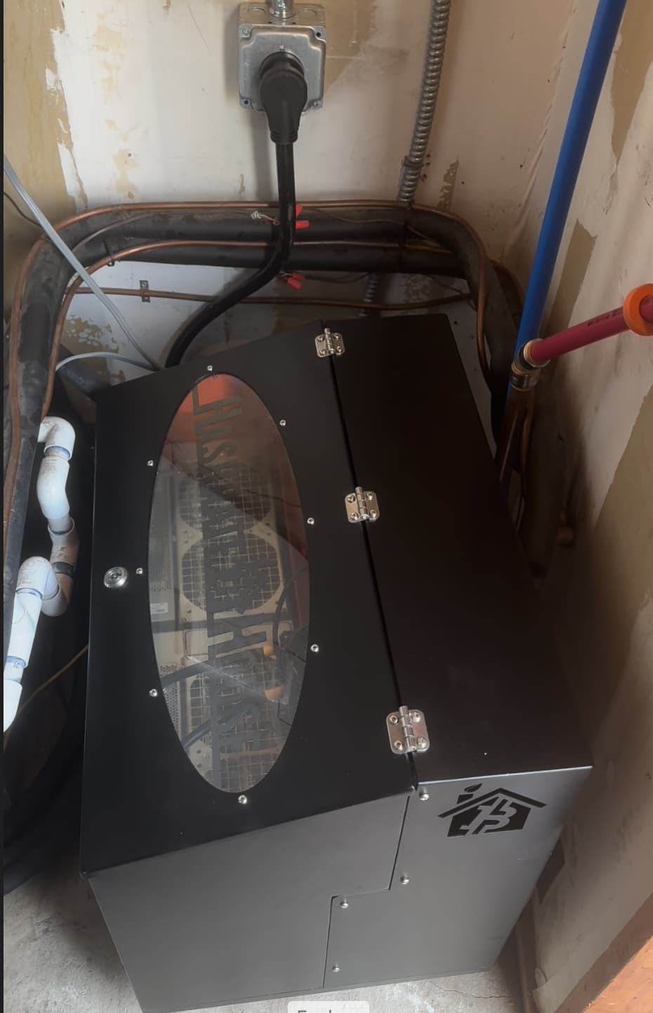

Hashrate House config
I had to add a power outlet for the system but other than that, everything was ready to go out of the box. I had to put some holes through the wall to get the dry cooler where I wanted it (in the garage). Other than that it was just a matter of prepping the miners and dunking them.
I set the dry cooler temp to 50c so that I could capture the heat into the hydronic system. This means the miners are running a little hot but I’m still messing around with finding the sweet spot. If i kept it at the default of 40c i found I wasn’t making enough heat to get the tank up to temp before dumping to the dry cooler.
