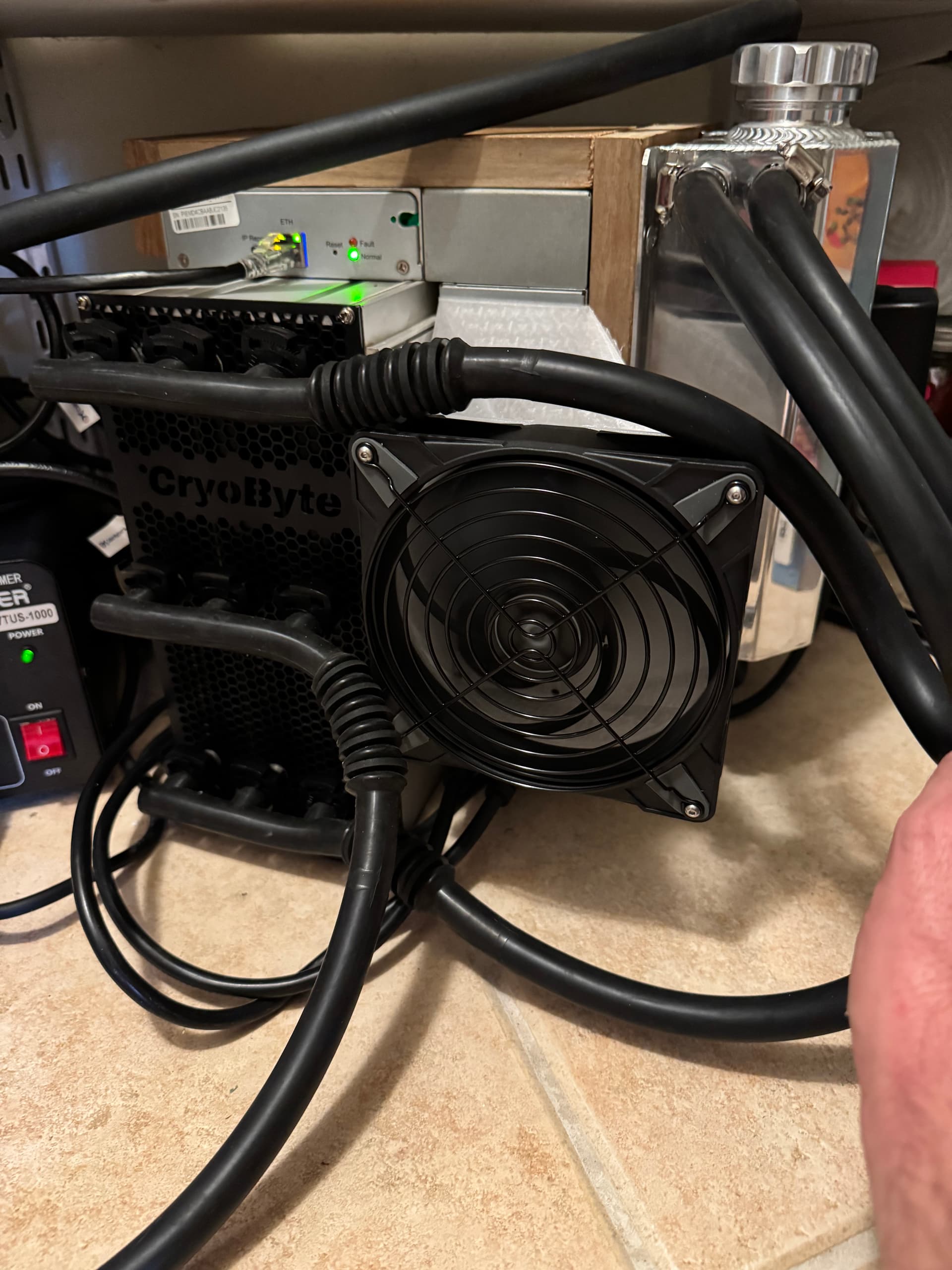

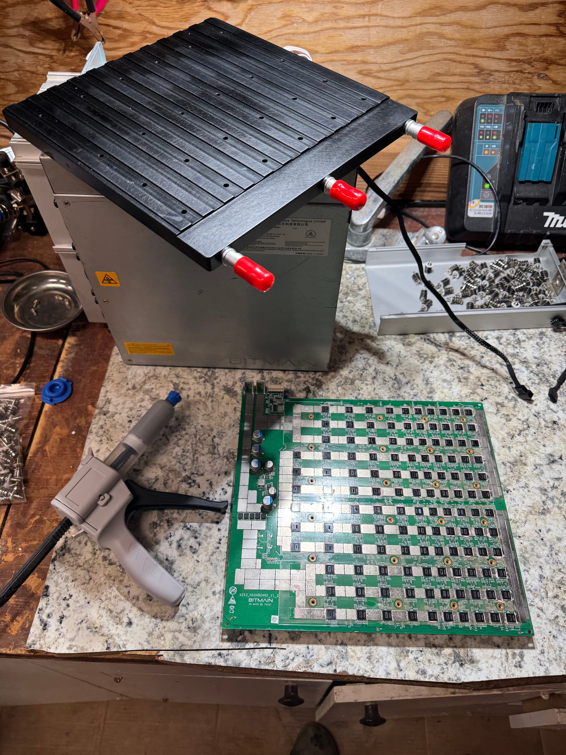

Here’s my domestic hot water heater setup. The core component is the CryoByte water plates and a brazed plate heat exchanger. This lets me heat up my hot water tank (and preheat new incoming cold water) using hashrate. My goal was to keep it as simple as possible in terms of control (no home assistant etc.). I like the hydro approach vs immersion in this case since it takes up very little space.
Big thanks to folks like Schnitzel, RevHodl for the inspiration to tinker and to Ryan at CryoByte Labs for making the hardware that makes this possible.
Miner side (distilled water):
  • S19J Pro
    • CryoByte Labs cold plates
    • Modified power supply 140mm fan/duct for noise reduction
    • Luxor firmware with ATM
  • Aluminum reservoir
  • Generic hot water circulation pump
  • 30-plate brazed plate heat exchanger
  • 360mm radiator + quiet fans
  • EPDM tubing
  • Misc fittings
  • Corrosion inhibitor in distilled water

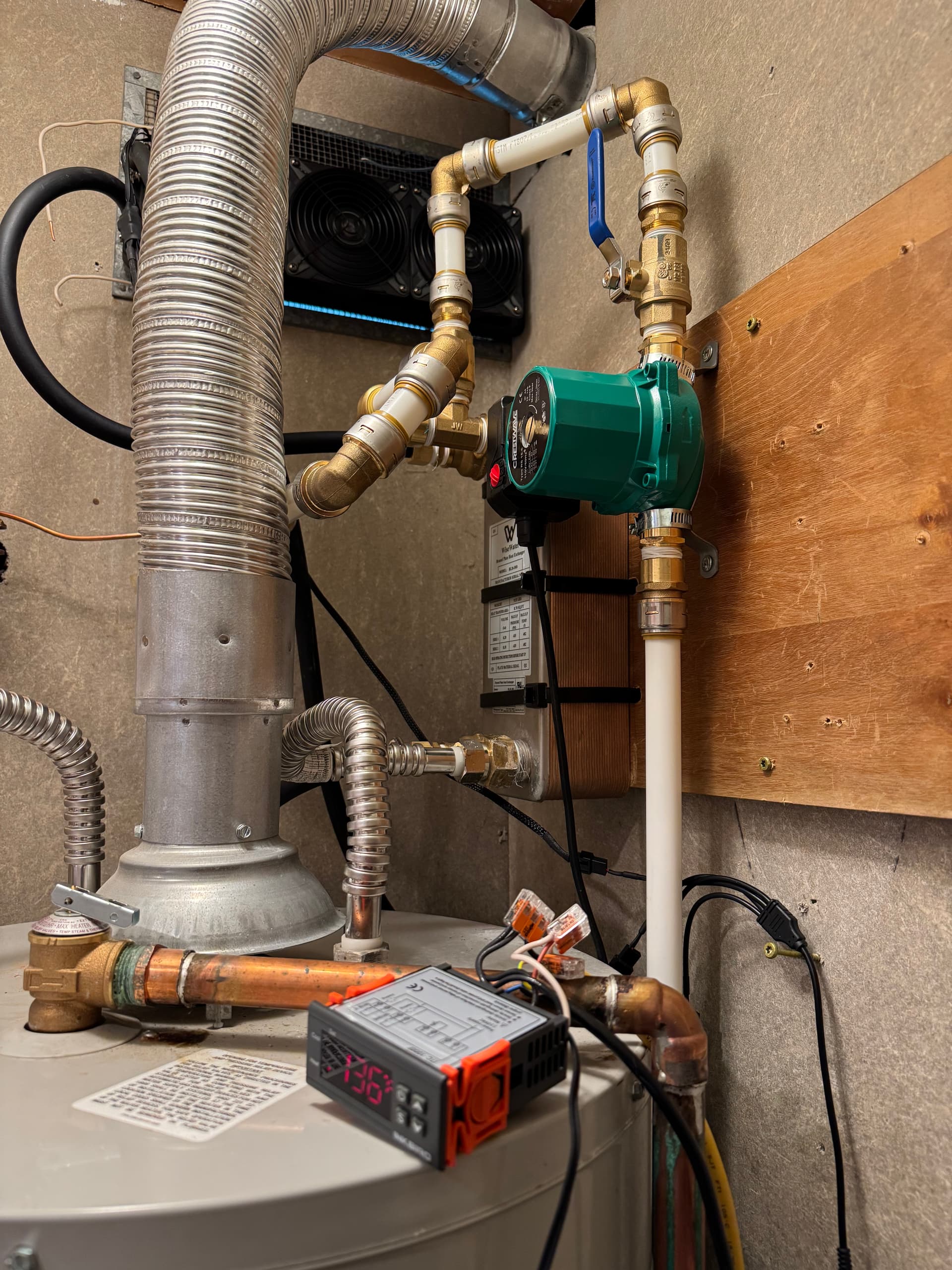

Water side:
  • 40 gallon domestic gas hot water heater
  • Add pex pipe to water heater drain valve
  • Check valve and tee at the heat exchanger input
    • Tee with cold supply in
  • Thermometer to set target temp and control pump
Control/Logic:
  • Thermostat: If water temp < 140f, run water circ pump
  • WiFi smart plug: If between 4pm - 9pm, turn off pump ($$$ electricity rates)
    • Water heater gas knob is set to 115f so showers between these times (or long showers) will be powered by gas

Initial observations/thoughts after running for a few weeks:
  1. A radiator, heat dump, or using the miner fans is necessary if you want to get the HWH up to 140f in a reasonable time. You can go from 110 → 130 no problem but after that the differential is too small and boards overheat unless you dump some excess
  2. I’m running a cron job to sleep the miner during peak power times and at night. It turns back on in the morning so it’s ready for showers, laundry etc.. . I like this approach more than a home assistant setup since it is way simpler
  3. Luxor ATM feature scales up and down very nicely as the HWH calls for heat. I set the ATM timing to 1 minute and it adjusts quickly. If someone’s having a long shower it can overclock like a champ as the cold water comes into the tank
  4. Luxor doesn’t let you shut down individual boards via API if you’re using ATM (ytho?). It would be nice to cut down to one board once the HWH temp is getting close to/at target (135f-140f). More efficient to have one board at about 400mhz vs 3 boards at 100mhz.
  5. We don’t use enough hot water to justify the full 3kw. This unit could easily provide heat to half of my house in addition to the HWH. It could be a “central heat mine” and have branches to radiator in the HVAC, pool, etc..
  6. Pex and pipe insulation is cheap - you don’t need the miner to be next to the HWH if you can run pipes from wherever you have the power
  7. Need to insulate the components (tubing, HX, reservoir) otherwise the room will get pretty warm (unless you want that)

Followup:
I have caved and started using home assistant to more intelligently control the water heater. Now that it’s getting warm here I don’t need the extra heat in the room.
Since the thermostat on the pump is not network enabled, I am using a wifi plug with a built in power meter for the thermostat/pump to detect when the tank is calling for heat. If the tank is at target temp, the pump is off and the plug reads low wattage and I can curtail mining. Otherwise if the wattage is >50w, the pump is running (tank is calling for heat) so start mining.
Still going to try to run pipe out to the hot tub or pool to use excess solar once I am motivated enough to crawl under the house…
