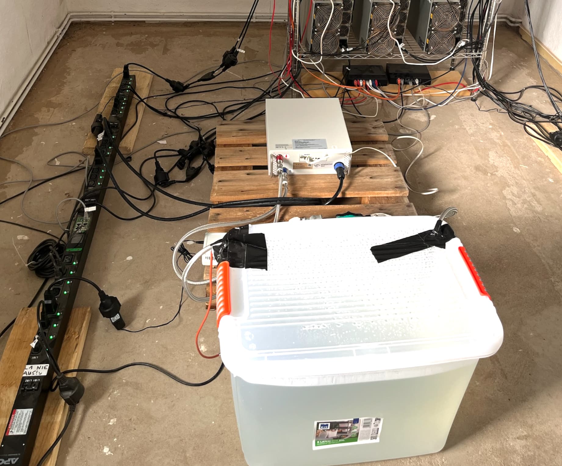

Initial M64 Hydro Test – 80–90°C Outlet Water Achieved
We ran initial tests on the M64, and results are promising. Hitting 80°C outlet water temperature was easy, and even 90°C was briefly reached without issues. We didn’t sustain those temps long-term, but it’s impressive to see the system handle them.
One downside: the Upfreq process is noticeably slower than on Bitmain devices. Our small water reservoir reached high temps quickly—before the unit hit full 200TH. In early tests, we didn’t observe major differences between low, normal, and high power modes. Interestingly, we achieved 200TH on low power mode during the first run (took about 25min of upfreq).
Conclusion: 80°C operation is clearly feasible. For longer tests and real-world simulation we’ll have to integrate a dry cooler or other cooling source to stabilize temps and simulate customer environments more effectively.

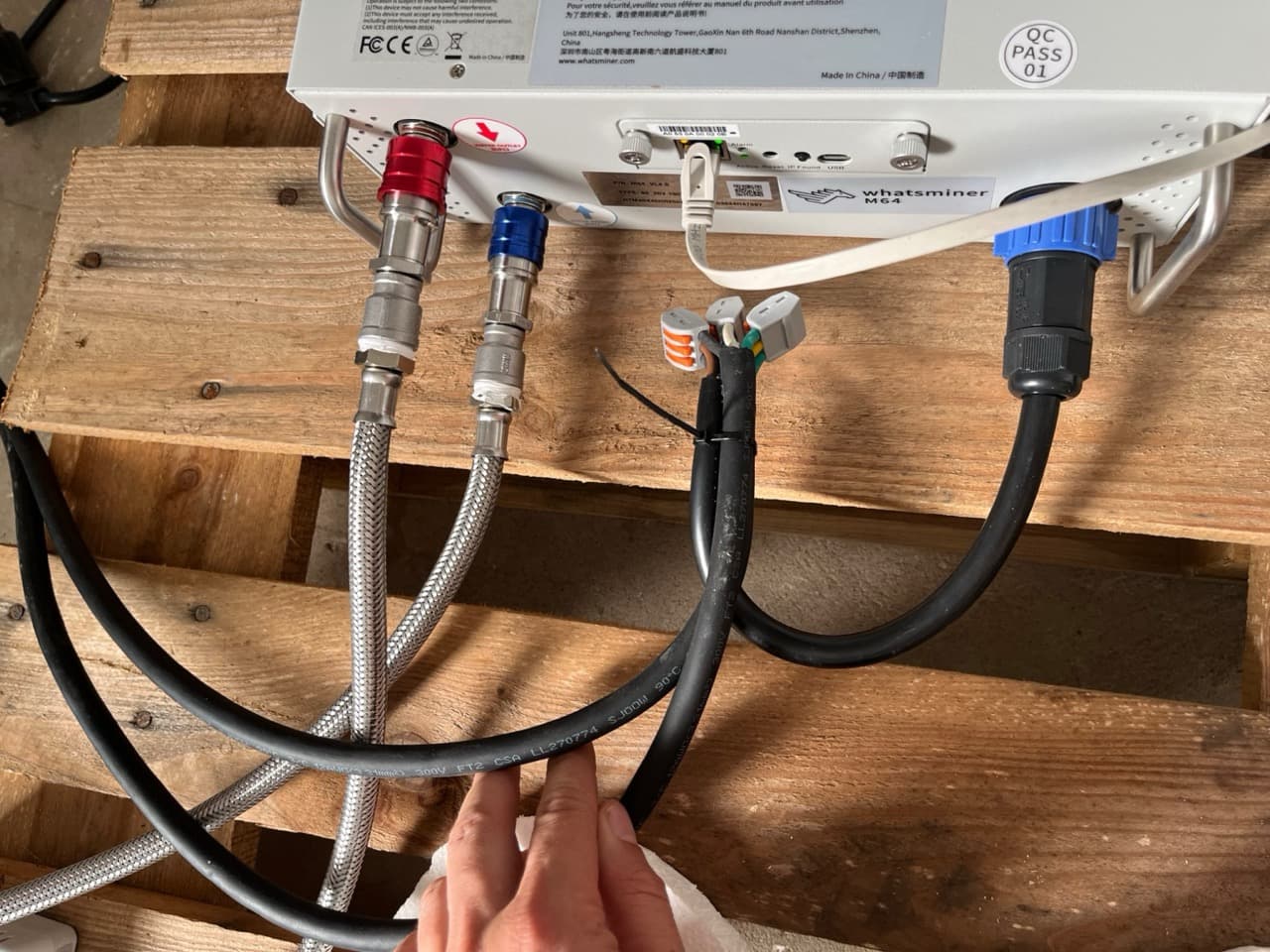

For testing, we connected two 16A C19 outlets from our PDU to the M64’s 25A input.
Important: Both connections must come from the same phase (e.g., L1). Using different phases risks a 400V potential difference — which can seriously damage the miner.

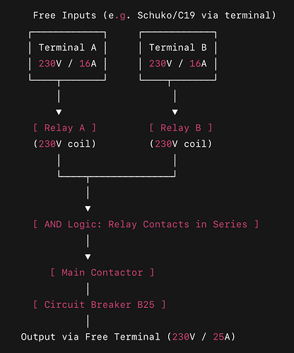

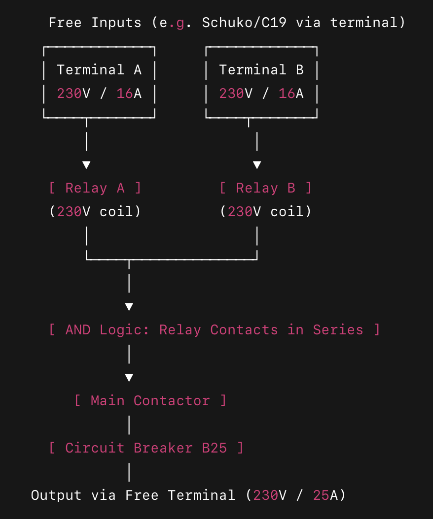

To ensure safe deployment in a production or customer environment, I designed a simple wiring concept that our electrician will now build. It allows the M64 to operate safely using either a PDU or two standard 230V outlets — as long as both are on the same phase.
Why this design?
The setup combines two 230V/16A inputs (same phase) to deliver a single 25A output. Since one input alone can’t supply enough current, both are required. Relay logic ensures that the output is only enabled if both inputs are present. If either input fails, the circuit shuts down entirely — preventing overload and ensuring safe operation.
