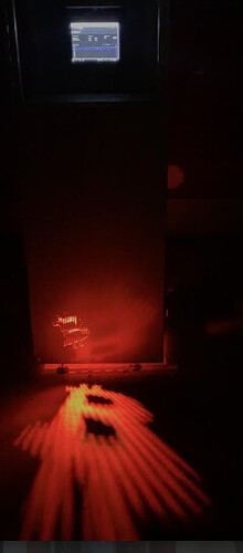

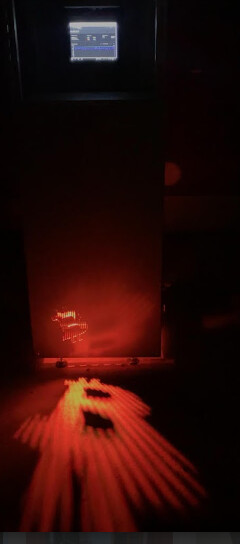

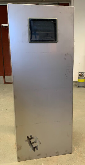

Im switching to hydro system now in the future for more easier install etc and better hashrate and output temps. Is there anyone who has tried to control hydro systems power in take according to water temp?This is my next step in my project for our BTC Boiler.
Ps what do you think about this ? :slight_smile:
